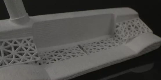

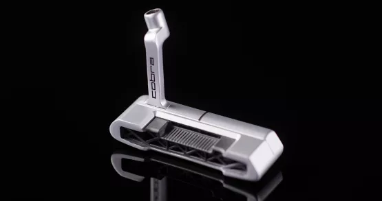

Here, the warm art of putting meets the cold science of physics. To create the club’s steady touch, Cobra Golf designed and printed an array of lattice beams, resting in the center of the putter’s head, opposite the face.
With 3D printing technology, Cobra was able to design a complex lattice structure that other techniques could not achieve.
The spaces within the latticework allowed the team to shift material usually residing in the center of a putter’s head out to its toe and heel.
“The new weight distribution helps keep the putter face from twisting on off-center shots producing truer putts and reliable distance,” Yagley says.
